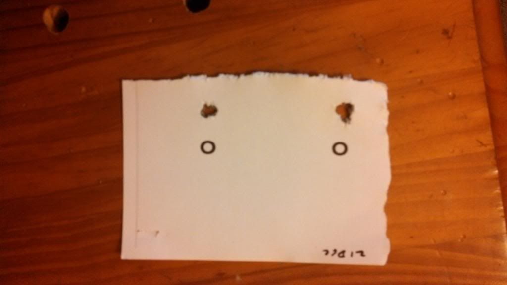

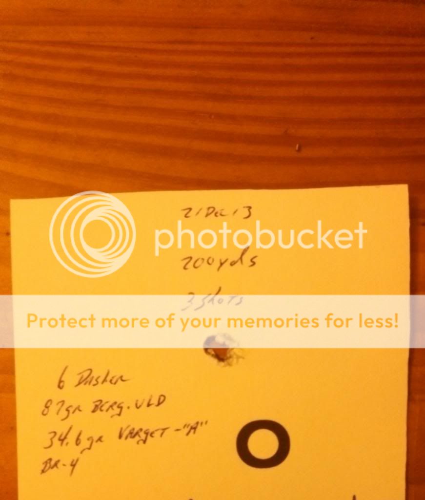

Timeout: I'm not sure if this will help you but I'm too damn happy not to post it. This is out of my Dasher so its a little hot for the BR but close.
34.6gr Varget
87gr. Berger VLD .010 off hard jam
BR-4
3300 fps
100 yards - 3 shot groups
200 yards - 3 shot group

Very nice, indeed! I just bedded a 6 BR for a friend yesterday. It was built by GreTan. Sure hope I can get it to shoot groups like your Dasher does! I can work out the load details, just not sure that I can steer it as well as you have done. It will be awhile until I can do the load work up and testing. Winter has set in hard here and I am dealing with my Mom's health issues. She is terminally ill and I've not had much time for projects. I'll work up the best load I can and if it doesn't print like yours at 200, I'll have to have you come and steer the rifle for me! ;D
