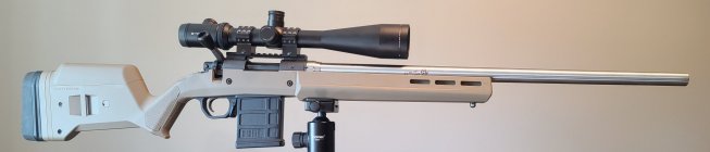

This Rem700 started its life as a 308win. It can be done with relative ease. I spun on a 6br Preferred Barrel Blank Remage and one of their barrel nuts. Criterion is another option. It takes a little more work than a savage barrel swap and needs a few tweaks to run perfect but it makes for a good project. 20210402_103749.jpg
