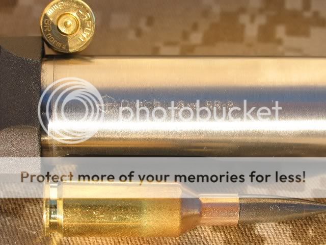

That photo back on P3 shows 2 AR15 bolts, 1 Oly wssm sized bolt for a 6BR and a 308 AR10 bolt so you can see the difference in the size of the bolts.
You would figure from there that the extension and barrel must be larger to handle that 3rd bolt.
Just waiting on carriers right now. Talked with Oly and they told me they would be able to go out on the 8th.
The Magazine insert that goes in mag works well in my Hagar.
I'm loving the gun so far and feel that once i've finished fireforming 500 cases it's still holding under inch at 200.
The cases that have been resized and trimmed for lenght are inside/outside neck turned to chamber deminitions and surely need it for some will hardly be touched and some take off alot.
Molly coating the 88gr.and seating to mag length is still up in the air but H322 looks promising.Berger 105's with VV150 also show promising results in single shot.
