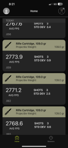

Here is what we have so far.
This is with N150 just started powder testing at .020 jump.
I will test some more as I get time, but will probably load 29.9 as my charge.
I did test 30 grains and .080 jump just on a whim. Numbers were similar but velocity fell to 2774fps 3 shot group about .37”
Lot a times you will see velocity dip or plateau when you’re close. Why are you not going until you see pressure? To me it’s important to know max even if you wind up way below. Especially when you mess around in the lands.
No real reason to not continue to see pressure, I just don't feel like its going to do anything for me. Especially being that ill seat the bullet with a jump of at least .030 or more.
with the numbers porvided what were the three shot groups sizes
