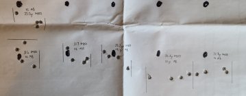

Finally got this combo to the range yesterday. Sadly it did not perform in my barrel. I ran from 31.6-33gr and had no pressure signes to speak of. 33 showed a hint of promise but I likely will not be pursuing this any further for this barrel.
This barrel has shot groups in the .1s, .2s, and .3s.
Something is loose.
Nope. Started the day with small groups and ended it the same way with a good shooting load. I would have thought the same thing had I not ended the day with small groups.
What bullet/powder combo did you use to shoot in the .1s and .2s?
Varget and pretty much any bullet from 55-105gr. I was hoping I could get 4350 to work since I have more than a full pound of that. Would like to try those 112s with varget as well to see if those were the issue.
Yes, I suspect this was a contributing factor with those 112s.
H4350 seems a little slow for 6BR. I would try some Varget or RL15.
