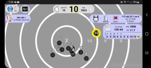

Haven't shot mine at 1K yet, but I too have a 28" 6BR. I have 112gr Barnes Match Burners loaded up with Shooters World Long Rifle pushing 2675 fps that I will be using for long range at Camp Perry in a couple weeks. So far the results at 600 show promise. Here's a 10 shot group is shot in a sling without any scope adjustments. Shot 10 was my fault.
