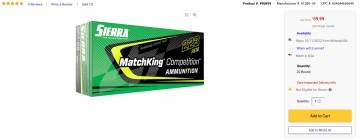

Currently available:
Not cheap but in stock at least. The velocity listed by Midway if from a 24" barrel.
