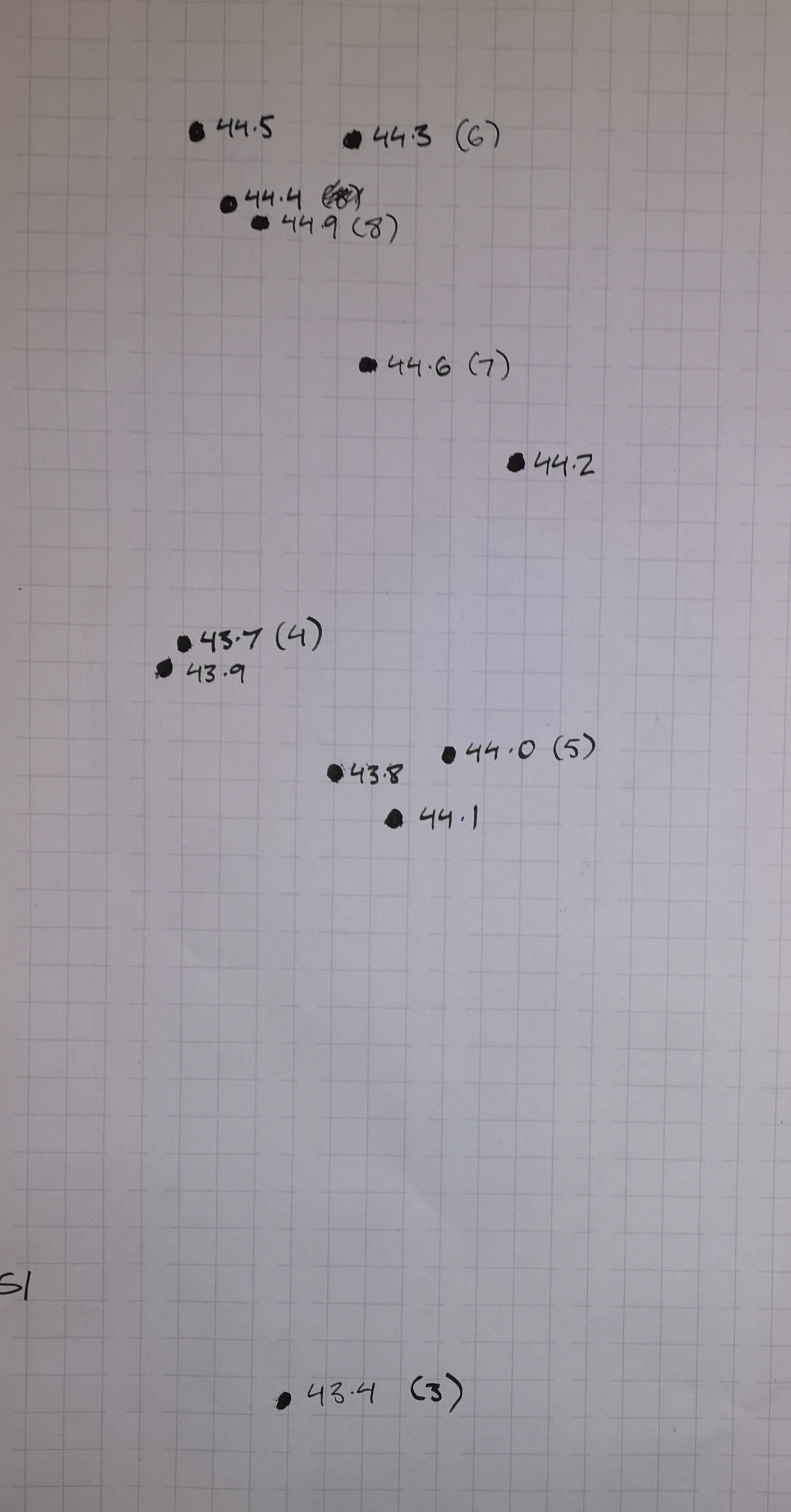

OK gents - round number 2!
Not exactly the results I was expecting. I shot loads 3-8 from yesterday's ladder and between 4 and 7 I went in 0.1gr increments The numbers in brackets represent the corresponding load number from yesterday
Today's conditions were not as favourable as yesterday's with a mild gusting wind. I am time poor when it comes to shooting, so I elected to shoot the ladder and do my best to pick still conditions. I am confident wind took shots 43.7 and 43.9 wide and possibly high. There's 2.2" of vertical between 43.7 and 44.1 and the ladder was shot from 600 yards. This node would be about 0.4gr wide.
44.6gr destroys what might have been a good node at the top.
So accurate shooter forum - load up number 43.9 and start playing with seating? If the horizontal in shots 43.7.and 44.1 was not wind induced, I should be able to dial that out with my tuner, I would expect.
I'm a little flummoxed - load 43.9 is more in line with the results of the first ladder, so my inclination is to use it, but I'd appreciate the input of those more experienced than I. I would also like to know if a half grain wide node is what I should expect to see in a 308 using 44ish grains of powder.
Thanks again, all the advice is much appreciated.
This target is a little more complicated. It would be helpful if you could simply put the corresponding charge weight next to the appropriate bullet hole. If I understand the notation correctly, it still looks like you may have something worth pursuing on the new target around charge weight #5 (same nomenclature both days?) and a higher node around charge weight #9 (day #2 nomenclature, between #6 and #7 from previous target?). Although I don't shoot bullets that heavy in a .308 Win case with H4350, in my hands, I've never seen a node with a .308 load that was 3 or 4 x 0.3 gr increments wide. Not saying it isn't possible, but that would be a really wide window for a .308 case. That made me wonder a bit about your previous results, where 4, 5, 6, and 7, were all closely grouped vertically. To be honest, it doesn't necessarily matter. This target suggests that testing in a finer charge weight increment than 0.3 gr around #5 and possibly #9 will still get you where you want to be. Yes, it means more charge weight testing. However, a ladder test that can be reproduced is one that gives you confidence you have selected the appropriate charge weight to work with further. Stick with it.

Thank you so much for your input - it's been very valuable. I updated my last post with a plot of today's ladder with the corresponding charges next to them. I also put yesterday's numbers in brackets next to them. I think you worked out my scribble on the other target anyway, but the updated post should clarify things.
Charge 5 seating depths then chrono sounds like the logical next step
Did you shoot with flags? Any chance being short of time , you rushed your setup or delivery ? What was direction of wind gusts ? Any chance there was some vertical-inducing turbulence, headwind or tailwind affecting vertical placement ? You should find the meat of the node to be min 0.4 grs wide, and would prefer 0.6. Consider switching powder if you do not quickly achieve that. Consider this second Ladder was blown ? Seating test: 3 shots each incremental change. Starting pressure will be significantly lower, so further powder titration afterward, in tenths, 3 shots each, and you’re done. Once load optimized and chrono Ed, backfeed into Quickload. Adjust to match proven MV. Bet you come in at 1% longer than OBT as an aside

Maybe it is just me, but I think 44.3, 44.4 & 44.5 looks very promising. Those are 1/2" squares? That would mean about 1" vertical in this group. I would load 10 rounds of 44.4 and see how it performs. If the results look good but need some tweaking then i would perform the Berger seating depth test to see if it would tighten up.
Just my 2 cents.
Just my 2 cents.
He already mentioned that those charge weights are killing the brass. Likely too hot.
