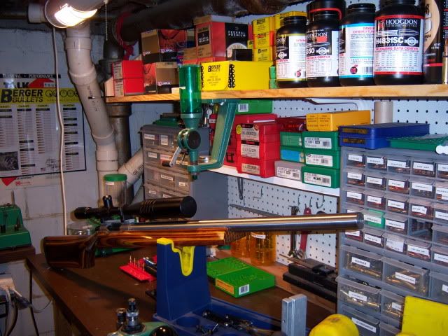

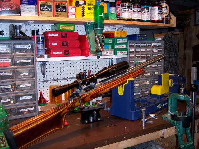

come on fellas. This could be fun. Everyone likes looking at cool toys. Here is my 6.5 creedmoor. Its a true hammer!!!! I think i need to get another barrel for it, maybe a 1.250 8.5 twist 6br?? I can use the Creedmoor for windydays, and the BR for still summer days. Enjoy Lee
Where did you get that recoil pad for your Shehane stock?
I have a new ST 1000 that i want to use a soft pad on not the aluminum one for my daughter.

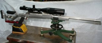

6BR is very good for 600yds. Here is my rig I can use on a bench or F-Class open. 6mmbr, My homemade stock holding a Savage target action.

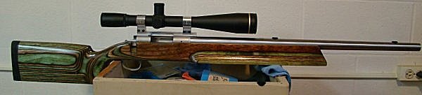

I finally got my stock finished . It's a Baer MBR laminate. I finished it with 6 coats of hand rubbed linseed oil . Note the missing bolt , it's on the other side of the country at Gre-Tan's having the firing pin hole bushed ,and the pin ground to fit both in length and od.
Trued Remington model 700 , Krieger HV barrel 26" , 269 neck , .104 free bore. Leupold 45 competition 1/8 min dot. Jewell trigger set at 2 oz.
Never thought of hanging my Uniflow like that.
