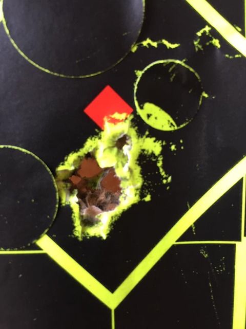

I shot this 10rd group off a bipod and rear bag prone out of a Savage Model 12 FCV 1-9 twist. That's a pretty good group for my skill level.
