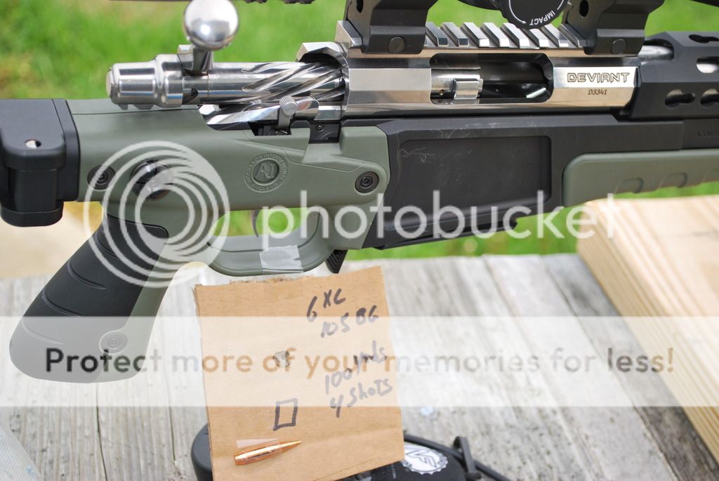

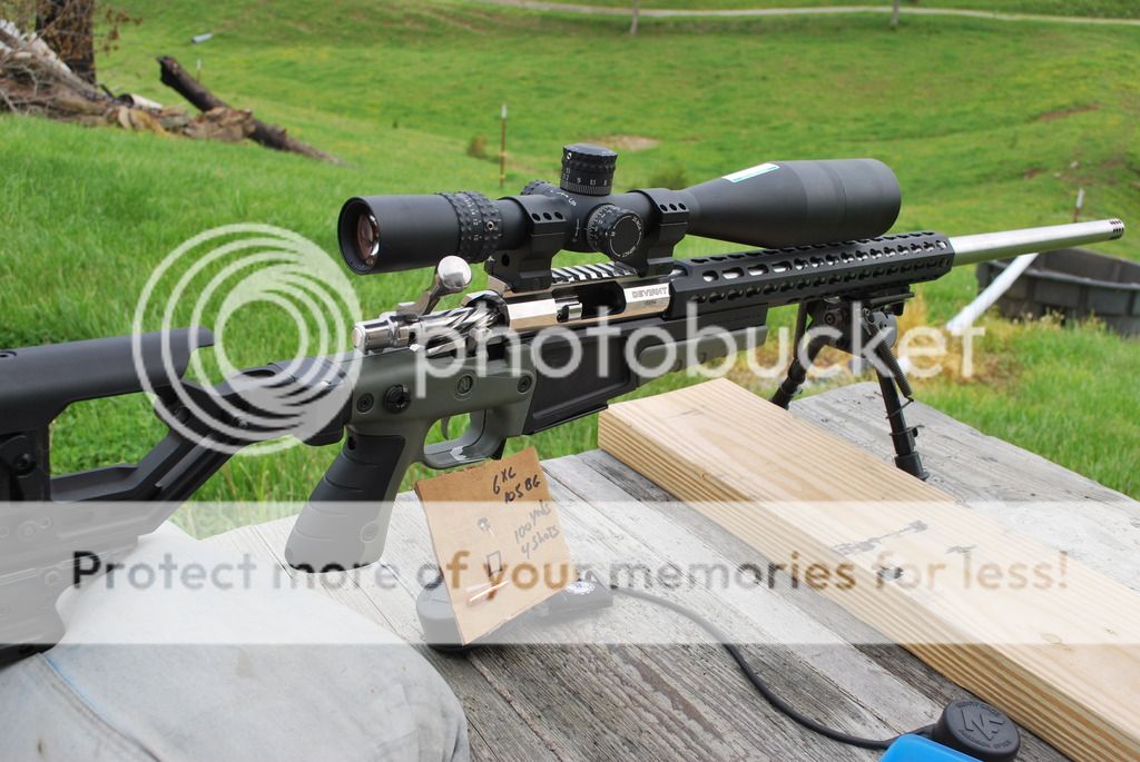

Here is a 6XC on a Accuracy International stock. I did this barrel work and am shocked by how fast he found a load. 105 VLD and H4350. This was a set back from a Dasher with 1500 rounds. He sent a new fluted blank which was said was going to be melonited in Arkansas. Both 6XC`s. I am about to order the XC II die from 6mmar.com and get brass etc. I used Whitleys print for the XC II and made my adjustments to it.
Very nice rifle :) What is your bullet speed and load recipe used for the target in the pictures? (primer, charge weight, brass, etc...)
I asked him to chronograph that load to see if there was an advantage with the larger case. I have not heard back yet, he just took delivery Friday 6/24/15 and the first afternoon tried IMR4350 and Tubb 115`s and got 1" groups. He thought it may be bedding and was about to proceed, I asked him to switch components, and in short order on Saturday sent me this picture. Norma brass, Redding S-Type XC II die, H4350, Berger 105 VLD in the lands.
Sunday he sent another pic of 80 grain Bergers on a steel plate at 300 yds that would easily be covered by a dime, 3 shots. My buddy is truly a talented shooter and rifle tuner. When you chamber barrels for junebug, he makes your work look great!!! He and mr.big live the same area of TN, and shoot together, both guys are excited about accurate rifles!!
