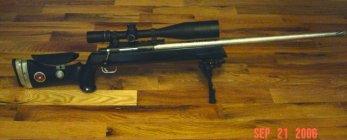

I think the 6 X 47 Lapua cases with a 105 Scenars is going to be a great round. I've included pictures of a metal target at 700 yards. As near as I can measure this is a 0.735" group, only 3 shots. That's a dime taped below the group. Shot off a Harris bipod.
Lapua 6 X 47
105 Lapua Scenars
41 grains H4350
CCI 450 primers
3250 fps
30" Schneider 7 1/2 twist P5
RPA Quadlite action
273 no turn neck chamber
Only case prep resized with 0.267 neck sizer, trimmed and chamfered, bullets not sorted.

Great looking group! It also looks like you have a great place to shoot. We are envious. I can get 3030-3050 fps out of a BRX but can't reach the 3250 fps that you are getting. Do you have any experience in the wind?
I am lucky to have 3 good ranges in the immediate area. Two are limited to 600 yards, this one has targets out to 1550 yards, you could put targets out much further than that if you wished. Has road access to 1100 yards, you have to hike after that. The range is backed by a 2000 vertical foot rise.
Unfortunately it is a public range and people don't realize what a treasure it is. Much trash, broken bottles, etc. Safety is an issue.
Volunteers clean the range frequently but it is still painful.
The range is quite often windy, mostly right to left and left to right shifts, 5 to 15 mph. Sometimes no wind, sometimes more.
I used 1 1/2 MOA of right windage for these shots.
I think a really good marksman with this cartridge is going to do very well.
I should have a 6.5 X 47 Lapua done next week, hard to believe it will shoot any better.
