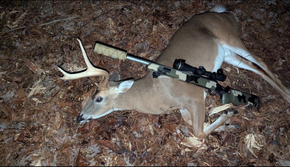

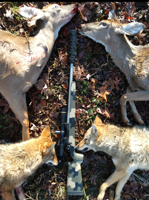

Have shot about everything made (mass production anyway) from 58-85 gr in it at one time or another, at least to try. It's easy; shoots most everything pretty good... But found the 70s to really be the sweet spot. For a long time I shot the old Berger 69 HBCFB in it. Shoots them like a bench rest rifle (and still have several packs though that bullet has been discontinued) and killed deer and larger varmints very well also. However, it wouldn't open well on crows and the small stuff, just knock them over with little dramatic effect. Switched back and forth winter/summer bullets for a while until I finally decided to just stay with 70gr Blitzking solely. It still shoots those in the .3-.4's but kills fantastic; small critters and large. I know that bullet is considered a varmint bullet but at puny 6x45 velocities (2970 in my 18" barrel) it's plenty for our NC sized deer, when taking and making good shots from solid shooting position. Will also leave a stream of feathers out of a crow. Just a fun do-all rifle. (When not anticipating much more than 300 yards or so)
