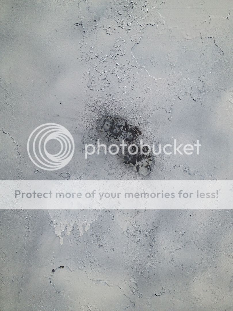

I have had excellent luck with my 6 AR/6 Grendel using Vhit N540 but I wanted to try Varget. With no data out there, I used RL-15 data as a baseline with the Berger 105 Hybrid. I decided to start at 26.5 gns and go up from there in 0.3 incriments. Loaded OAL was just inside max mag length using pointed 105s.
I started to get some pressure around 28.5 gns. The 27.9 load showed promise so I loaded up 30 rounds and headed back to the range to see how it did at 600 yards.

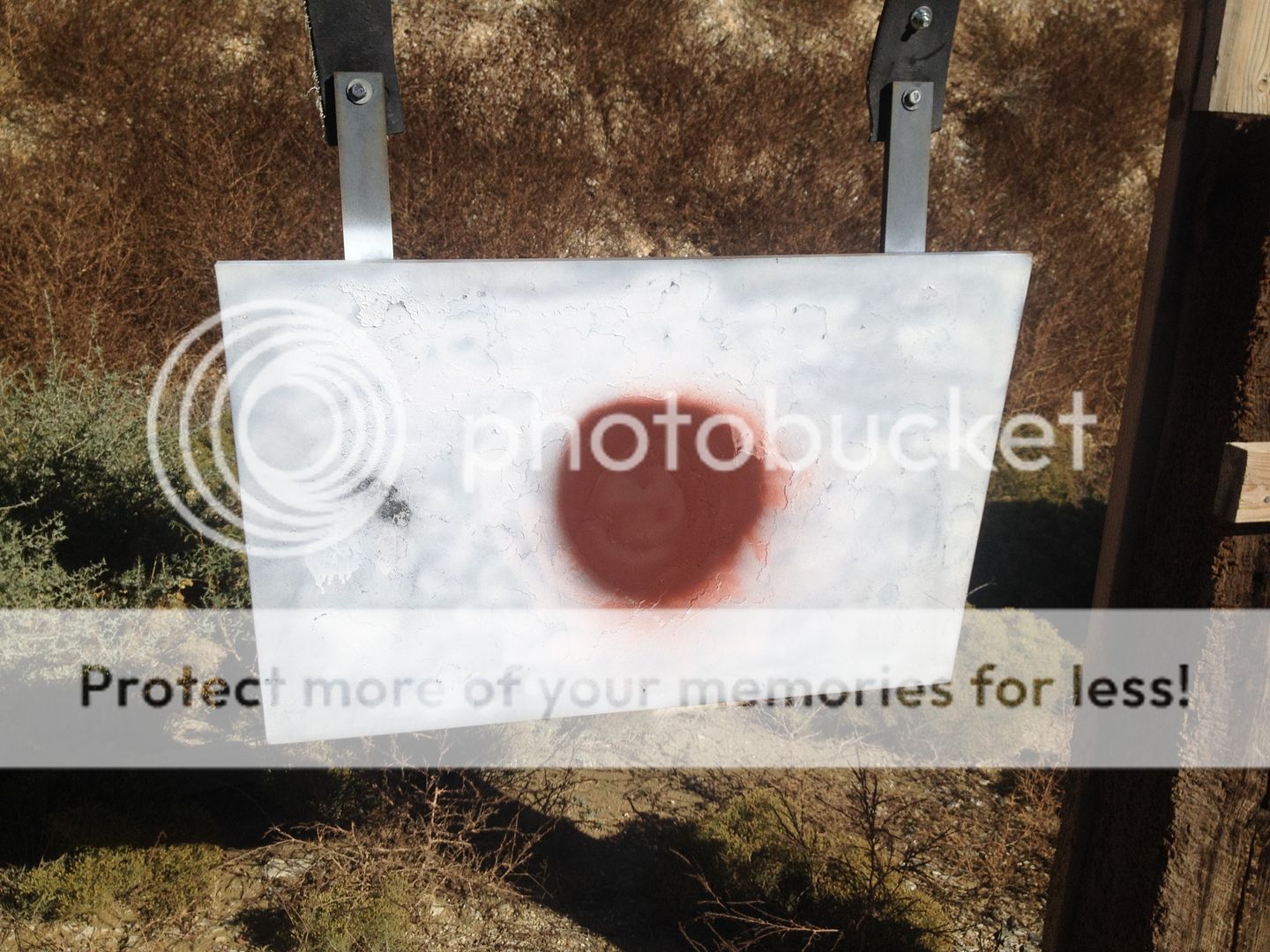

18x36 chunk of steel.
That is 5 shots inside about 2 inches.
Looks like my gas gun has a new load.

Just think what woulda happen if he was shooting at a much smaller target... ;)
He would of still missed it by about a foot to the left....:)
Nice group though.

Well it was windy out... About 10-12 mph.
My point was aiming at a 1" dot is more precise to aim at as you have a better point of aim then a 8" painted circle dot.
I highly doubt at 600 yrds you held exact same spot of center.... Good shooting but as the saying goes " aim small hit small"
