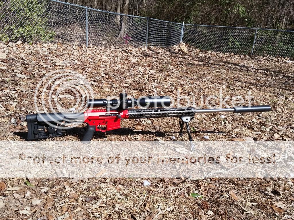

Here is the rifle for those who want to see.
27" Hawk Hill barrel with +2" gas system
Lancer Carbon Fiber 16.25" Handguard
LuthAR butt stock
Billet 80% lower and Mega side charge upper

Boltfluter, thanks for the compliments on the rifle.
