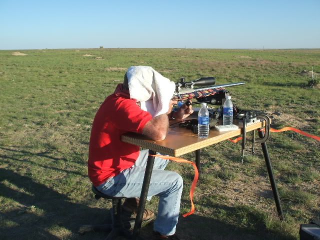

Here is my set-up for a 1394 yd dog kill witnessed by Voldoc and JR Carter.
Used a towell for sunshade. Viper 6 mm Dasher

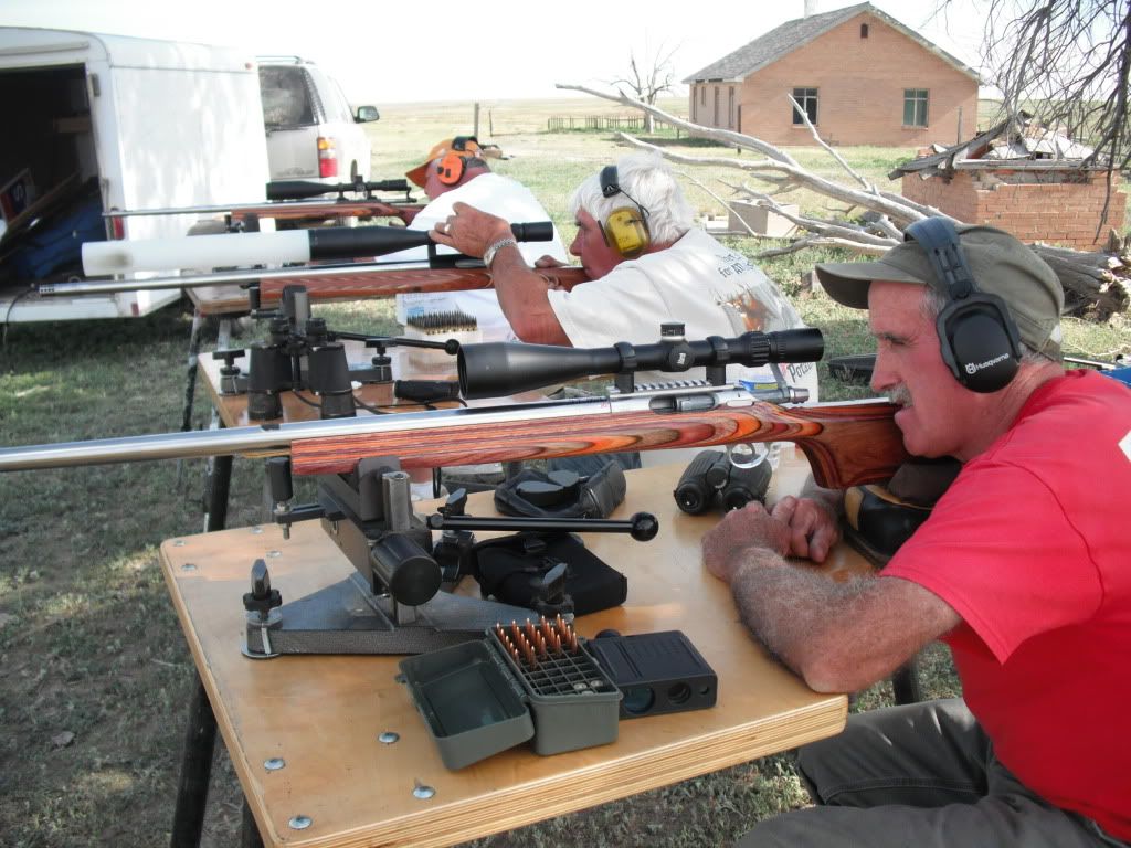

Voldoc, Kruzan, & myself set-up for 1,000 - 1200 yd.
Voldoc is shooting a 700 6 br, John Kruzan a Viper Dasher, myself a Diamondback Dasher

This photo is from the'09 PD Safari and Voldoc had just
made his first hit at 1,000 with the 87's. We were having
a 1,000 yd shootoff. He jumped out ahead. I loaded
12 more rounds and made 2 hits to tie the score.
