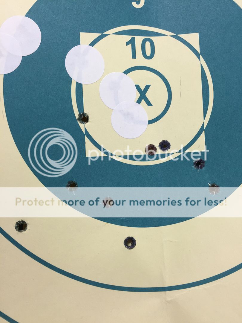

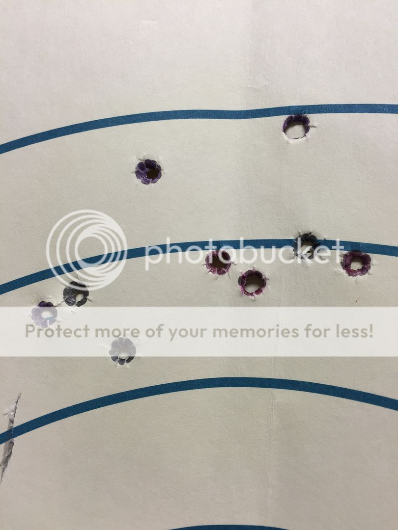

To keep my and the other posters results seperated for time being. I made it to the range today to test some of the new IMR 4166 in my 6 Dasher with a Krieger 8.5 twist barrel using the Berger 108 BT

My loads started at 32.0 grains and went up .3 grains to give a bit finer tune on velocities and when I got to 33.2 I stepped up to 33.4 grains a .2 grain difference as I didn't know what to expect in pressures and played it safe.
Results are as follows
32.0 avg 2917 fps ES 19 group size 2.067
32.3 avg 2942 fps ES 12 group size 2.050
32.6 avg 2977 fps ES 14 group size 2.354
32.9 avg 2989 fps ES 9 group size 1.154
33.2 avg 3016 fps ES 7 group size 2.738
33.4 avg 3042 Fps ES 7 group size 2.047
These groups all were only 3 shots and shot at 500 yards.
I'll pick back up hopefully Saturday morning and test some more loads with increased powder charges up hopefully close to 34.0 grains if I can.
Targets are attached
Target #1 are loads 32.0 32.3, and 32.6 grains
Target #2 are 32.9, 33.2, and 33.4 grains
As you can see as the charge went up there was less verticle in the second target I'm hoping to find the next accuracy node some where around 3050-3060 fps
