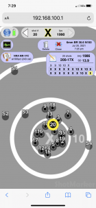

Will defer to @ShootDots experience but may be able to help. I am running a straight BR on 30.6 grs. N150 out of a 28" Krieger HV 4-groove barrel pushing a 105 Hybrid Target at 2850 fps. No pressure signs at all. Could likely squeeze more velocity out of it but it is not really a competition rig. Here is a target I shot with it last night:
