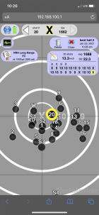

I shot 1000 yd f class Saturday and tried RL 26 and H4831sc and 4831sc was better, less vertical, went with 44gr at +.010 jam
I am pointing this Bullet also, but did not sort OAL or anything else
this is first time past 100 yds with this rifle
1000yd tuning and pointed vs not
+.010 43.70 gr h4831 sc = 3011 FPS avg, SRP
Turned the tuner in about 3 marks to get here
tried LRP with same powder charge and didn’t work, 60 faster, will back down and try it next
