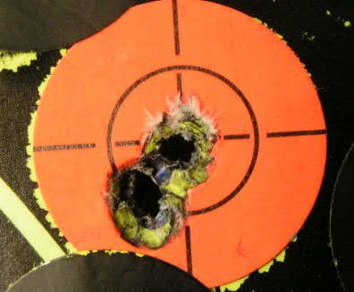

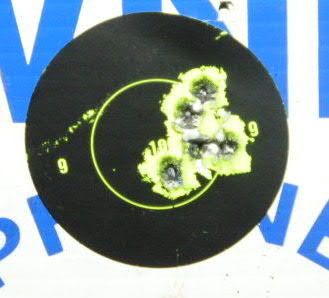

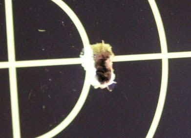

I have a Savage with a Pacnor bbl. Magnum sporter bbl contour, .625 at the muzzle if I remember correctly. Below are some pics of groups I have fired with this rifle using SSA factory ammo. Unmodified factory tupperware stock. Pre-Accutrigger with a probably 3 lb pull. No windflags, shot before I ever fired my first Benchrest match.
The top group is 3 shots with the original SSA Extreme offering. Goes 2700 FPS in this rifle with only slightly flattened primers. The 5 shot group is with the SSA Matchking load after they reduced the powder charge. The bottom group is probably 3 shots, can't remember. I just looked at my notes which say this is 3 shots measuring .215.
Anybody that says the 6.8 won't shot good groups is an idiot. Judging a round's accuracy potential with crappy factory bbls is a farce. Typical modern 'journalism'. If you asked the guy how much he was bumping the shoulders on his reloads he probably wouldn't have any idea what you were talking about.
