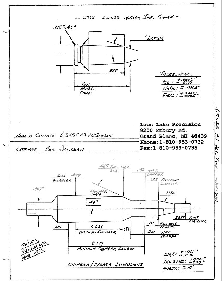

The guy at Redding who has done all of my die orders sent me a copy of the reamer print used for the dies. It is the same print Bob Jourdan sent to Dave Manson when he worked at Clymer. This includes still having Bob's name on the sheet.
From my email from Redding customer service:
"Note: SAAMI base diameter for the parent cartridge is .4794, about what the original Clymer reamer design should cut.
We have made a Type S Bushing Neck die for this version of the cartridge. The p/n is 71759.
With the Bushing Neck die, eventually you will need a Body die to bump the shoulders, it's p/n is 75759.
We have also made a Type S Bushing Full die, p/n 77759.
The full length die set is available, p/n 80759"
I had Dave Manson duplicate the original reamer he made for Bob Jourdan.
If I need to order a different size die, I'd sure like to do that before I size all this Lapua brass.
What dimension is shown for the neck diameter on the print? From what I can see, the part number listed is a 6.5x55 AI die set.
0.298" neck
