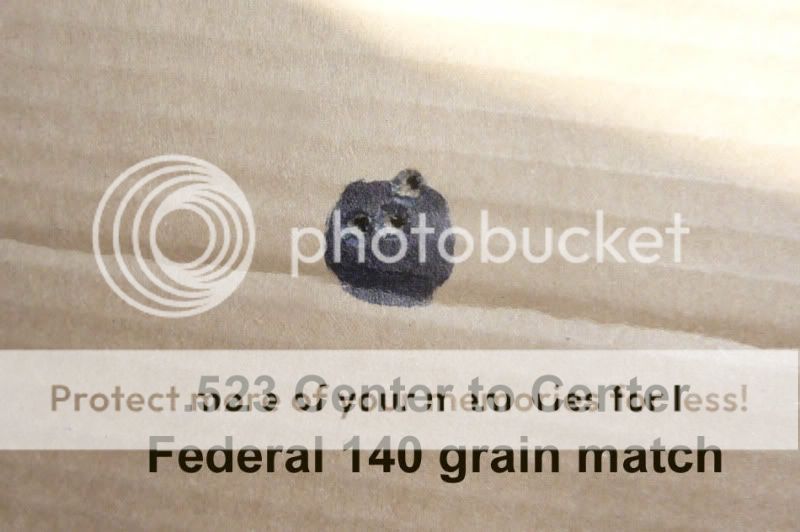

oddly enough I shot some 140 grain match today and got 1 MOA, but I suspect the gun is capable of much better with lighter ammo

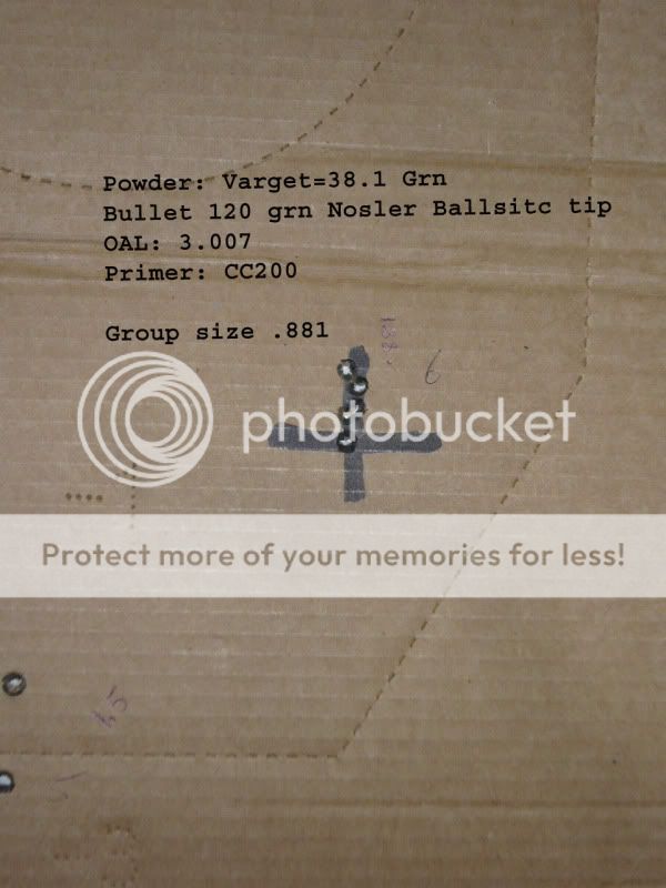

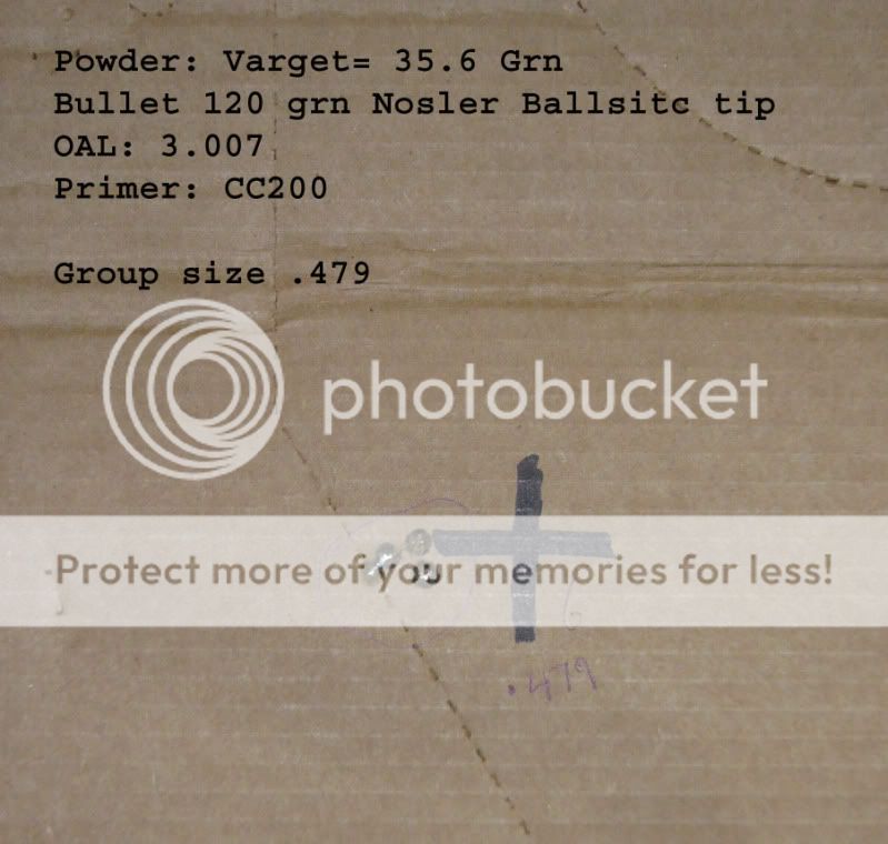

ok finally started reloading again with my Dillon 550b, I know its not the best for rifle but it works
I got 120 Ballistic tip Nosler bullets and Varget here is what I shot today
did not clean the barrel between loads
Target 4 was strange all were good shots but climbed vertical
6 shots
5 shots
6 shots
