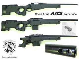

In the CIP datasheet the minimum freebore length is 0,177".
That works great for all bullets.
It`s a great cartridge for short actions (like Rem700) because you never get OAL problems with the magazines like the 260 Rem.
I make a lot of Custom AICS rifles based on Rem700 short action - also in 6,5x47 - great tool for shooting on long distances ;D
