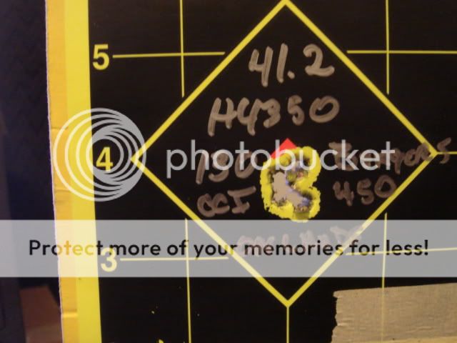

I am most definately no expert as to an answer to your problem, but my 6.5X47L Rock Creek 29 inch barrel shooting 41.2 grains of H4350 under a 123 MK is giving me 2931 fps on my Oehler chrony. If possible try another chrony and maybe a different lot of 4350. But the 24 inch barrel may be handicapping you, but I would think not that much.
Frank

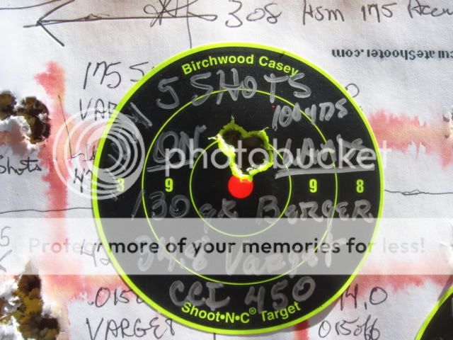

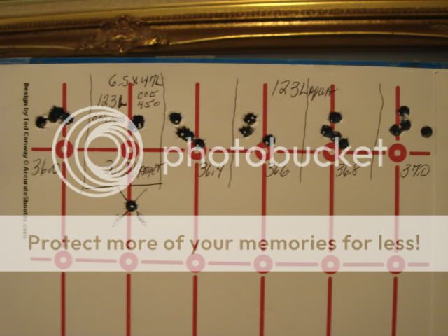

For some reason my 6.5x47L loves 120 SMK's with RL15!
It also likes 123 Lapua's with varget. The below picture gives all info.
28" McGowen 8 twist barrel
I have tried 130's and have the best results with Varget, 34.9grns, on lands. Speed is not there with this load, but look at the group below!
4350 Might be a load to continue working with!
