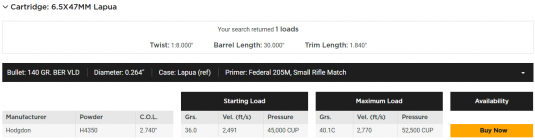

This isn't you exact bullet, but after doing this many times I can vouch for the starting point and agree with the rough idea of when you will hit compression.
ETA: they show a long test bbl, but don't let that distract you.
I’m sure that’s with lapua brass,not Peterson
Agree, but if the search starts at 36 grains, it won't matter because you hit compression with that powder about the time it gets hot. Most rigs will want to be lower than the max when they perform. YMMV
