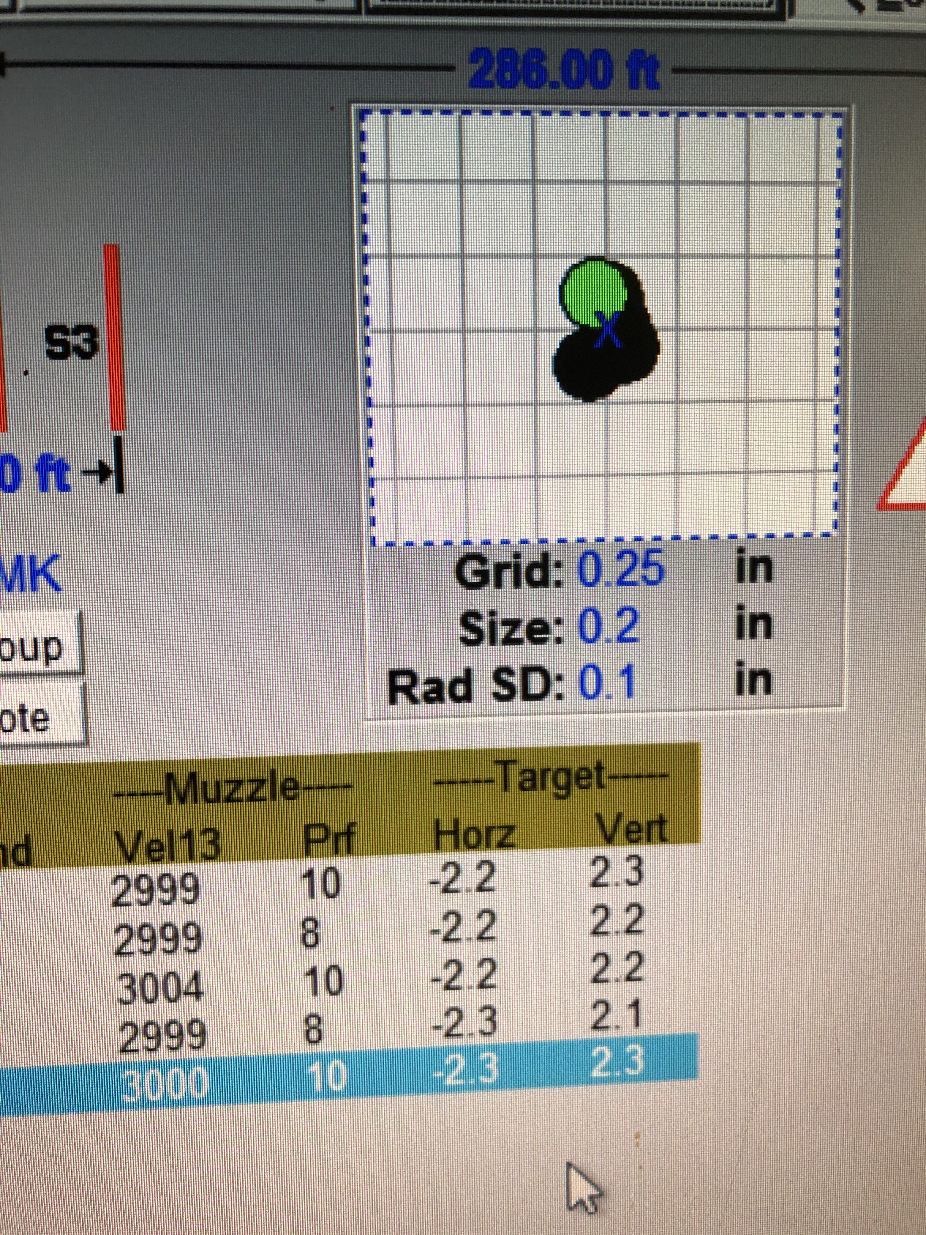

I've just swapped stocks on my 6.5L and thought I'd recheck the load while I was at it. I'd been jumping the 123 Scenars a touch so went with a jam for comparison. The screenshot is off an Oehler 43 system. I can live with the lighter projectiles as it'll only be used on targets up to 600yds.
BTW, AR2208 = Varget. This is only a 27" bbl but it's showing no pressure signs despite the decent velocity.
