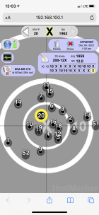

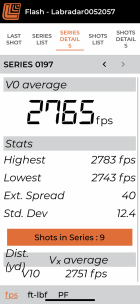

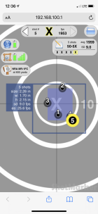

I got my first 6.5x47 barrel cut by a new smith and it spit this out during barrel break-in. I then decided to see how it held and turned the delay and sighter period on my shotmarker, and this turned up. I literally have no load data and no clue where my lands are. I put some 4166 I had laying around behind some 142s I also had laying around. Just extrapolated some 4166 data from BRA and seen how it compared to others I had tested. Neat cartridge! These are shots 9-13 and 22-45 through a brand new barrel. I’m shocked.
