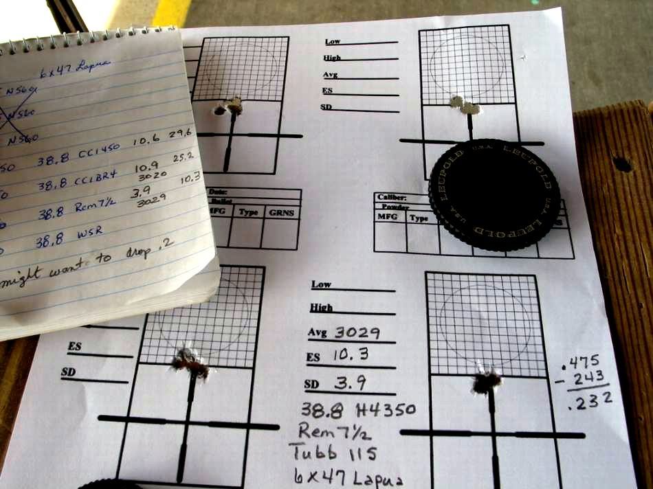

my 123 Scenar load used the WW WSR and SDs were always less than 5 and 2-3 a couple times for 5 rounds,,
hit 10 eggs in a row at 300 twice with that load and the 4 inch swinger at 800 would take a beating regular,,
