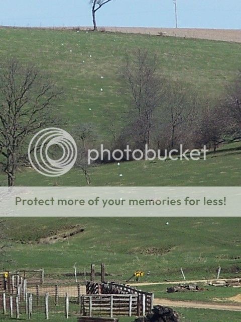

Fun Day.......filled up 24 milk jugs with water & 4-5 drops of food coloring in each:
Got 'em spread out up the hill towards the lone tree, from 550 to 1020:

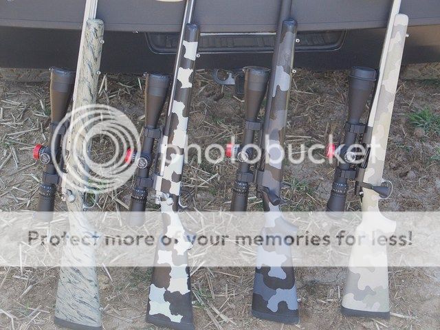

Brought a couple others along for the play date..........
Left to right, 22-204, 6 Dasher, and the new 6.5x47 Lapua:
It's called "show and tell" now that you showed us, do tell at least about the dasher, build, load etc.
22-204 is a S/S 700, 24" Kreiger Rem Varmint contour, McMillan Marksman stock, 40 MOA NF base, NXS 5.5-22x50, runs 80 VLD's at 3025.
Dasher is built on an older blued 700 that has been hard chromed, 26" Kreiger HV contour, McMillan Marksman stock, 40 MOA NF base, NXS 5.5-22x50, runs lighter load of 105 Amax at 2950 for potential hot prairie doggin' temps.
Managed to find a couple three more jugs, so I got them filled up, drove out to the favorite spot again, and spread them out up the hill from 625 to 1350 yards. I moved my shooting spot back through the gate up into the farmer's field a ways, giving me another 150 yards to play with from the time before:
Today's players......
22-204 - 6 Dasher - 6x47 Lapua - 6.5x47 Lapua
