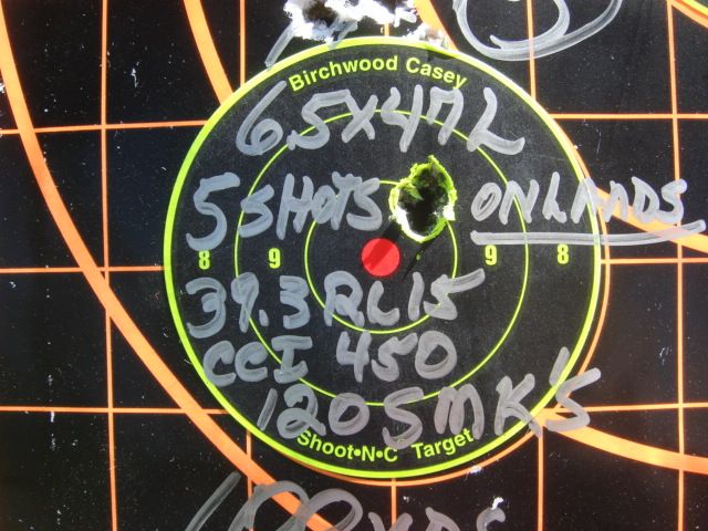

This works for me, 120 smk's, I am sure Scenars will do the same.

Mine likes 39.5 RL15 Wolf Sr Mag. primers.Tommy Mc..

shot 1000 of them with 40.9 of h4350 .020 off in a 109 freebore best load ive ever had in the 6.5l in the .1's
39.3
PLEASE start your charge lower and work up. I have 2 of them and both love this load.
