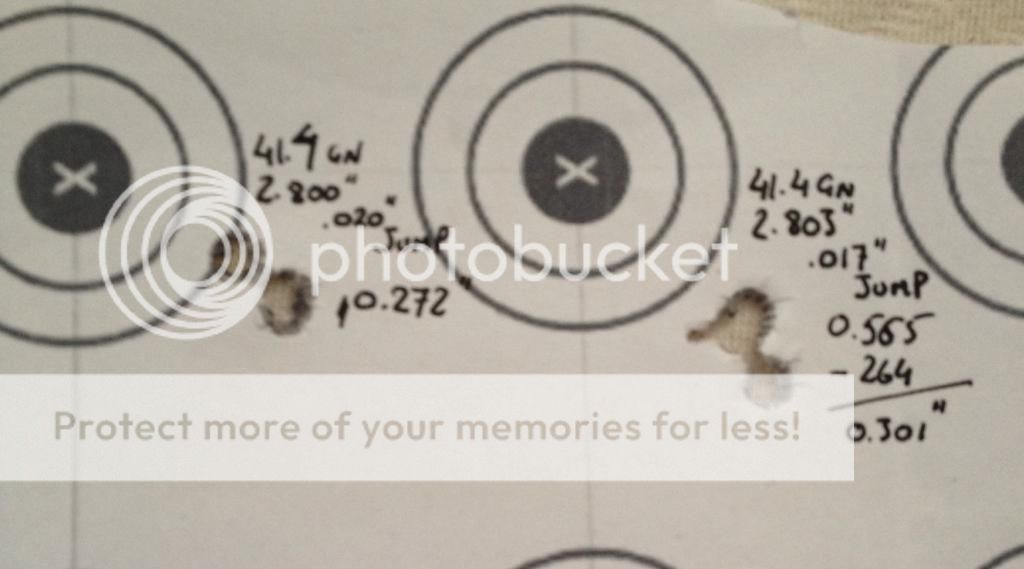

Update on the load development guys:
I got hold of a dvd the other day, Long range precision shooting by Todd Hodnet from a friend of mine but i hadnt had a chance to watch it......until last night. I cant believe how much my shooting was to error. Loading the bipod...never even heard of that before and tried it today and with goes results. Shooting position was off aswell. The way i was gripping the pistol grip on the AICS was probably making me pull the rifle over by squeezing my finger and thumb together on the pistol grip. This time i kept the grip to the outside, pretty much the way i used to shoot the .223 when i had a Bell & Carlson Tactical stock on it.
Here is a pic of the group i shot today with 41.4gn charge seated with a .020" jump and same charge with a .017" jump.
Only problem is........I had to use new brass as im still waiting on my Redding FL Bushing Die getting delivered so i cant resize my fired brass. I do have a Forster FL die but there is a problem with it and its scratching my brass. I got hold of a neck sizer but the shoulders need bumped back cos i cant close the bolt with neck sized cases. Thats why i had to use new brass today. New brass neck size measures .287" . My neck sized and FL necks measure .289" so i had an extra .002" neck tension today with the new brass and straight away i ran into pressure signs, stiff bolt to open and plunger marks on the case head when i didnt have that with fired cases. Obviously the extra .002" is producing too much pressure. What can i do here ? The ES wasnt as good as it was in previous test with neck sized cases.
I also tested the 41.1 gn charge as suggested in previous posts. These ran into pressure signs straight away also, ES wasnt as good as previous test but better than 41.4gn charge.
41.4 gn charge:
2.800" jam -.020" : 2759, 2787, 2753
ES : 34
AS : 2766
2.803 " jam -.017" : 2769, 2796, 2809
ES : 40
AS : 2791
2.806 " jam -.014" : 2788, 2798, 2777
ES : 21
AS: 2787
Group for 2.806" was around .5" , never got a picture as it wasnt as good as these 2, but ES was better !!! it was the same POI as 2.803"
Donovan :
Thanks for the encouraging words there. I will post more results when I get more tested. Hoping to produce more groups like these.
