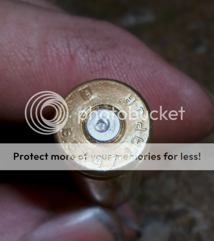

6.5x47 L 130 VLD H4350 max load
this was once fired brass and worked up to a case full of H4350 at 43.5 grs with CCI 450 primers,,I am not getting any sticky bolt or shiny spots on my case head,,load shoots real good for what I do,,quickload says I am over max but man it shoots good on that node,,
barrel is 28 inch Bartlien 8 twist 5R,,I think freebore is .170 but not sure about that,,I know I seat the bullets .010 off and the OAL is 2.830 ,

The print says .163" freebore. That primer is what I look for in my loads, a light cratering around the firing pin strike. Great loads will normally be uniform cratering among many cases and not just a small sample.

Great SD !!!. Load should have very little if any vertical dispersion. Fired round looks like you are close on pressure but the primer looks to still have somewhat of a rounded edge not squared off. Whats the expansion of the case above the extractor cut over a new piece of brass? .001 should be max expansion anything over that is excessive pressure. Have you shot for group yet with this load?

Is that a Remington action? Have you had the firing pin turned down and the bolt face rebushed? Firing pin hit looks a little cratered.
working up with H4350 I was shooting at 300 yards and went up to 43.8 but group was a little better at 43.5 so I loaded 5 and shot those with the chrono attached,,
