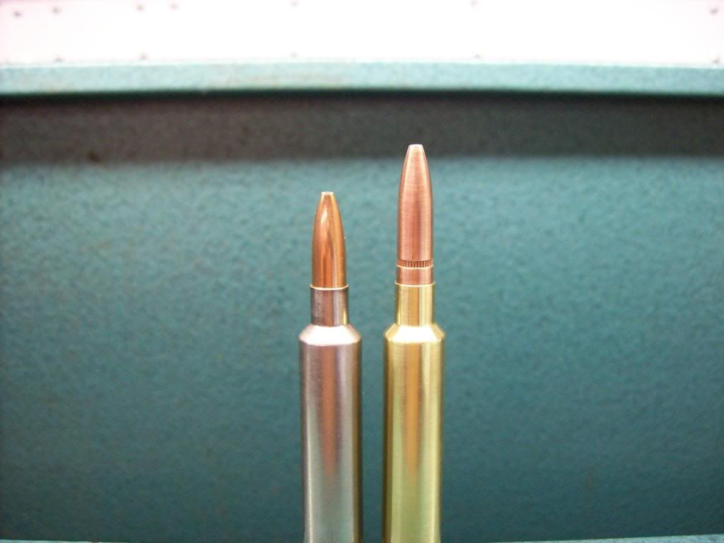

I also shoot the same cartridge necked down to 6mm, and it does VERY WELL!
6mmX444 Improved on the left, 6.5X444 Improved on the right.

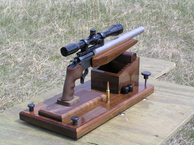

These were the first rifles and handguns built in 6.5X444 Improved, which in the hands of a competitive shooter, proved that a break open single shot like the T/C Encore is more than capable of high levels of accuracy at 600 and 1,000 yards.
According to the owner of this handgun, it has beat several bolt action rifles in 1,000 yard competition!
In a single shot like the encore, a "rimmed" cartridge is consistently more accurate than a rimless cartridge, which is one reason why the 6.5X444 Improved was chosen to go the distance.
