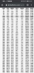

Haha. It eats 44.5gr ramshot hunter and it was not at all fussy.
Just loaded to pressure and kinda just stuck with it.
Velocities are slow. About 2500 according to my 700m test. No chrono.
Not sure if ypu can read the writi g on the targets.
