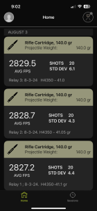

So I'm breaking in a new barrel that's a 26" vs the 24" that I've been shooting for the last few years. I initially tested some rounds 2 weeks ago using my old load of 41.2g H4350 in virgin lapua brass and CCI450 primers. I was averaging 2830, which I thought was a bit fast but I attributed that to possibly neck tension from just loading virgin brass.
I pulled about 60 rounds I loaded and ran my FL neck busing die through to get .002 tension. Bullets seated a lot easier. Rounds 50-70 came in at 2796. Barrel seemed to speed up with rounds 70-100 back up to 2830avg.
I guess I have to do some testing I was hoping to avoid. I'm getting some vertical stringing and the accuracy isn't where I want it. I know people these days have moved on from velocity nodes but what are you guys getting for velocity? Am I silly to think that if I lower the charge to 2775-2800 the accuracy will improve?
I mean it's not horrible but it's also not great.

It's a new and different barrel. You will just have to adjust the load and find the one that works with the barrel. What bullet you using?
I really only shoot Hornady 140 / 140 ELDM's right now working on a load for the 140s
I would go up 0.3gr and down 0.3gr and see what happens.
You wouldn't be worried about velocity? I see zero signs of pressure: heavy bolt, flat primers, ejector marks, but I posted somewhere else and was crucified for my velocity.
Just adjust the powder charge some and see how it does.
What's your OAL now? How far off lands?
I'm at 2.230 CBTO which is .020 off. That always shot great in my last rifle but may play with that.
.020” off is fine but just making sure you weren’t trying to seat them into lands. I have shot them at .070” off with factory ammo to my handloads at .020” off. Just adjust that powder charge some and find what the barrel likes.
And don’t stress that velocity. I have been shooting the Creedmoor since early 2008 and have loaded up to 2920fps and have some factory ammo now that’s at 2850fps in my 28” barrel so as long as it’s safe it’s fine.

one hole goal. lol don’t know if I’ll get there but I know I can get it a lot better. I’ll shoot a ladder next weekend. I was just hoping to get lucky and have my old load work.
Mainly though my question was on velocity. I posted on Reddit and got downvoted to hell lol. Most people I know have moved on from 6.5 so I wanted some opinions
2820fps was the original loading with 41.5grns of H4350 in a 28” barrel so you aren’t really high. Most load down in the lower to mid 2700s so why they probably jumped on you. Just didn’t know you can load there safely.
Still lots of 6.5 Creedmoor shooters out there. I have other calibers but the 6.5 and .308 will always be in the safe. I load the 153 ATIPS in my Creedmoor now. They are going about 2680fps with 40.6grns of H4350.
With a 26” barrel I do not feel you are pushing it over the top. I would drop the load down to around 40.0 and work back up and try to find out what that new barrel likes. Both of my CM barrels have performed well around 2720ish.
Be safe and enjoy the game.
I’m going to test this weekend. Probably drop down to 41, 40.8, 40.6. I’m confident the load will be in that range. 30-50 FPS less. only 100 rounds on the barrel but now I have 100 pieces of fire formed lapua. Also found a box of Hornady 140 match ammo. Interested to see what those do.
