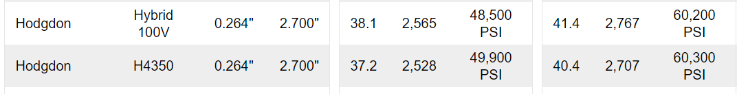

If it's all you have then use it but your velocities will be slower. Here is the Hodgdon page that has data.

OK, let's say you have 140 grain Bergers and IMR4064 powder and that ALL you have. Take at look at the .260 reloading data, maybe Noslers, and decipher some. The cases are somewhat comparable and there is info for 4064 powder. As mentioned earlier, it might be tough getting the velocity you want but that is the

If I were to do this myself, I would drop two whole grains of powder (about the difference in capacity between 260 and 6.5cm) and start there, but this is not advice for novice reloaders. Find appropriate data and work up. YMMV, etc...
I shoot 260 Rem and my buddy shoots 6.5 CM. Both of us have liked midweight projectiles (120, 123) and have used IMR4064. We have done load development and found the powder requirements are very similar. IMR4064 has been around for a long time. Hodgdon is trying to replace it with IMR4166 which is supposed to be more temperature stable. There are plenty of recipes for IMR4064 in (the older) Sierra Manual V5 for 260 Remington.
