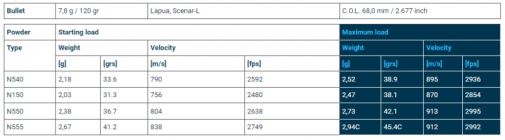

So I have Rem700 6.5 Creedmoor and on my bench I have 120gr Scenar L and a pound of N160. What would be a starting load to start with.

Why does that load data look so goofy for 160? The barnes 120 start load for 160 and max load is like half a grain apart.
Look at the 129 grain data and use those numbers for a better range of charges. The 129 goes up to like 44.1 and the 136 goes up to 46? Goofy.

What you're missing is the fact that most of the powder and bullet manufacturers who publish this data, neglect to hire and use properly educated proofreaders. They choose instead to use 'spellcheck' or some other ridiculous app which promises 99% accuracy. In this example, there is the fact of translation also. The people are not infallible and the translation software is ludicrous.
Transcribing technical data requires software which is designed to handle specific data. Human beings are still the best as far as proofreading against the copy. The problem with this though is that the proofreader has no methodology to check what is being proofread, only what it written.
Rarely now do powder and bullet manufacturers actually shoot real rifles and cartridges to achieve data points. They scramble around using whatever program seems to be consistently reasonable when input delivers the output. This programming has parameters by which it discerns if the data is within safe standards. Then figure in the lawyers who rule the world in the name of safety. Compare the older reloading manuals against the very newest manuals if you want an eye-opening experience in the effect.
In essence, VVN-160 is not really suitable when used in any of the combinations we might find as being safe in the 6.5 Creedmoor. Yes I understand that you have it on hand but I suggest using a different powder with the track record of providing sound, reasonable data for your project.
