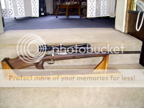

What you are making is an "un-improved" version of the 6mm Vais cartridge. As for pressure issues I built a 6.5x55 A.I. on a Swede military action and have had no problems, E.R. Shaw 1.125 barrel, Richards thumbhole stock, and it will group into one ragged hole at 100yards with 123grn MK's. 200yards grouped 1/2".

I have a 96 rebarreled to 22-250
Non expert advise. No. You could keep your loads soft but you have no way to measure actual pressure. Your action may fail before the brass has overt pressure signs. Anyone ?
I have seen articles listing the Swede psi tested to 60K psi safely, however I would keep load pressures (estimated with Quick Load and load manuals for rateings) to 45K - 50K psi. I run my Swede Ackley loads to just under 3000fps (best accuracy) with no issues or worries, don't recall what Quick Load had for estimated psi but it wasn't to high I know that.
I would like to hear more about that 22-250, M96 (OKIE2), I have a slick cocking piece mod I do to my small rings to improve the looks.
it was the first time I ever tried to rebarrel anything.
I took a Remington 22-250 varmit barrel and the threads for the Mauser is just right for when you cut off the remington threads I rethreaded the barrel and cut the shoulder so I did not have to do anything to the chamber and got the right head space. Then I fitted a richards thumb hole stock and bedded it
put a timmy triger on it. It turned out to be a nice accurate rifle.
