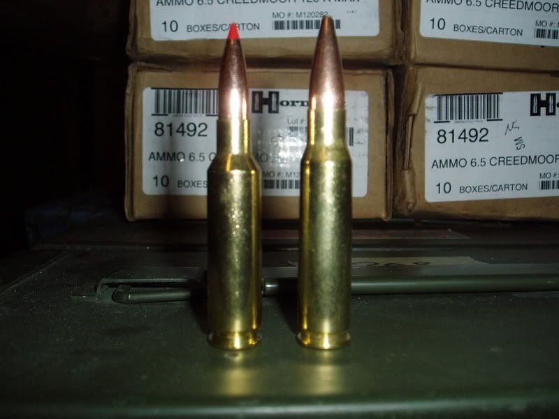

I'm having a 6.5 Creedmoor built right now at GA Precision. GAP Templar action, Manners T3 stock, Badger DBM, and 28" 8 twist Kreiger barrel. Should sling them out pretty good. The 6.5 Creedmoor is based off the 30 TC cartridge. Advantages are factory match grade ammo available in 120 AMAX and 140 AMAX as well as excellent brass from Hornady and many 6.5 bullets to choose from. Add to that the round shoots at lower pressures than other 6.5s and barrel life should be pretty good also. Hornady also gives you thier loads on the boxes of ammo to let you load to the same specs as factory if you wanted to. Hopefully it will be done soon as I have a bunch of ammo ready to go.
6.5 Creedmoor on left, .308 on right
