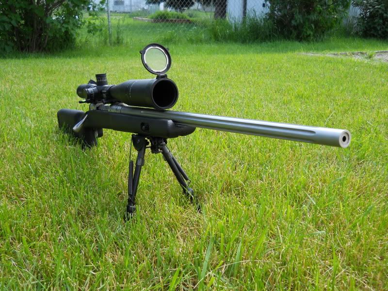

I have a 6.5 Rem Mag on a Savage 116 long action and shoot the 140gr Berger VLD's at over 3130 fps from a 26" barrel with a long throat chambering. Had the 140's going 3210 fps, but case life was short and that brass is hard to come by unless you form it from 7mm Mag.
I have had this rifle for about 5 years now and it is my main hunting rifle. Killed over a dozen animals with it from 80 yards to 655 yards. Even used it in 10 shot 1000 yard BR comp during one event for fun. Have a load that can shoot under 1/2" at 200 yards using 51gr of RL-17.
The long throat is nice for getting maximum case capacity to "hot rod" the round and get maximum energy at long range when hunting. BUT>>> The 6.5 Rem Mag will wear the throat and lands down quickly when pushed to the upper limits of speed. Just the same as any larger 6.5mm chambering. Since I jam the Berger VLD into the lands, I've had to chase the lands a couple of times now from wear and the long throat gives me less room to continue seating the bullet out before the case neck does not support it properly. I have had Berger VLD's shoot very well when seated far off the lands, so I might have to try that method with my 6.5 Rem Mag soon, or get it re-chambered and reduce the barrel length to 25.5".

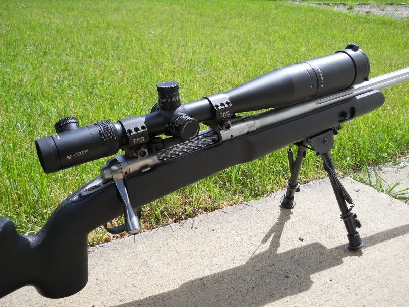

Here's some pics of the rifle and the accuracy I'm getting.
The rifle with a Choate tactical stock that I ended up getting rid of because it was too heavy for hunting. Looks good though.

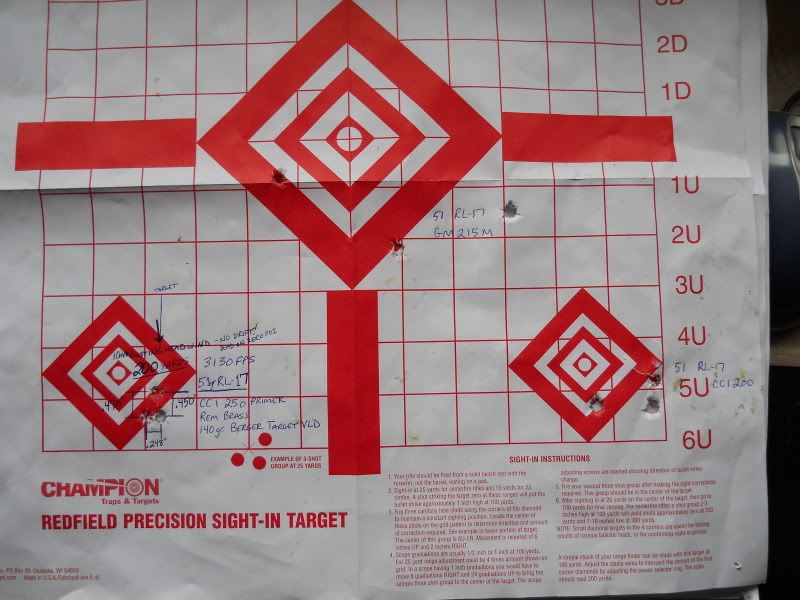

This is my best group at 200 yards. Load data is listed on the target
The same target showing two other 3 shot 200 yard groups tested on the same target. One is pretty bad using a Fed GM215M primer, but the other group on the bottom right is no slouch. Only difference between all 3 of the groups is the primer. Really shows how a primer change can make a HUGE difference in accuracy.

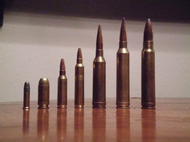

Picture of my 6.5 Rem Mag case with the 140gr Berger VLD along with a few other cartridges I have in various rifles. From left to right is;
22lr, 40 S&W, 20 VarTarg, 204 Ruger, 6.5 Rem Mag, 7mm Rem mag, and 358 Noma Mag
