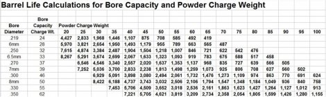

I do have that barrel life chart in my library, but take it as a loose guideline as my barrel is well over what it suggests since my powder charge weights are typically between 56 and 58 grs:

Your loads are likely too hot. Hence it is not staying in tune. Typical loads with a 147/153 gr bullets are in the 55-57 gr range. I know that ~58 gr of H1000, +/- 0.5 gr, has always been max with 143's for me depending on the rifle.
Back off and rework things. Realistic barrel life is in the 1200-1500 rd range depending on your accuracy requirements. In theory H1000 is cooler burning powder and should help too.
