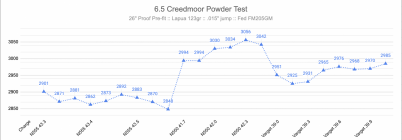

Here's some data I collected with 136 Scenar-Ls on H4350 and N550 in separate sessions. N550 data was collected in ~80F whereas H4350 data was probably ~60F. Also including data from a session with 123 Scenars ( N555, N550, Varget). All data from same rifle. The 123 data is kind of wonky bc I did 3 shot groups with N555 but 2 shot groups with N550 and Varget. fwiw I prefer N550 but ended up switching to H4350 bc I had 16lbs of it and thought maybe I should use that.

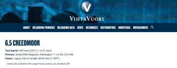

Just go right to the Vhitavouri site for load data......
I did. But reloader's that are actually loading different powders like Laurie, definitely give better information than that Vit chart.
