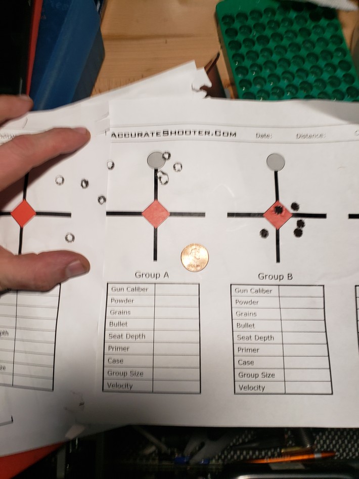

My results are just strange. Let me see if I can upload a few pictures that show the group sizes along with how the flyers are coming out. Keep in mind, some guys are going to say, hey, it's sub MOA that's good enough. It might be if this was an off the shelf rifle. But, that's why I order hand lapped custom barrels. I'm not OK with .8 inch or so avg. groups.
OK, I'm no pro shooter but I can shoot tight groups. Now I will say from a bipod with no rear rest I don't shoot sub 1/2 inch groups. That's more of a challenge. That puts me in the .5" to .8" range. But, I don't test with that.

I have only used the CCi450s. Have had really good results for years with them. Do you think a primer would make the difference between a .6 and 1 or 1.2" group?
