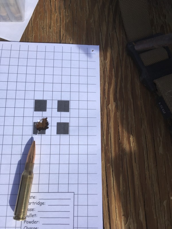

Me and another friend shoot these . They are very easy to load for . I use 43.3gn of Reloder 16 with ogive length of 2.195" in 6.5 creedmoor lapua brass . Another friend says that I'm missing out on the higher BC of 140gr bullets, but I can shoot these at 2950fps and surpass him shooting 2800fps with 4350 at 1000yd with a flatter trajectory .When I was working up my loads I never had a group more than 3/4" at 100yds . The 140 hybrids are similar , but in my rifle the 130s are king
