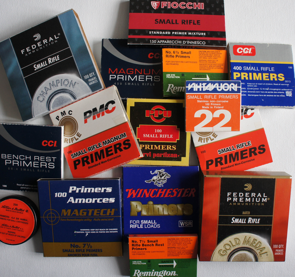

In addition to the small primer tests I did in SRP 308 Win mentioned by @Martin52 in post #12, here's an overview I did for people wondering about general pros & cons of SRP vs LRP brass:
https://www.targetshooter.co.uk/?p=4072
Thank you Laurie, for this extremely thorough article on the subject. It pretty much answers any questions I had -- and I've still got a decision to make.
