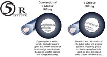

Look up the shape of the 5R rifling grooves vs. Traditional grooves and you will clearly see why they clean easier.
Traditional grooves use 90 degree shaped cuts that make it hard to get copper from the corners of the grooves. The sides of the grooves in 5R rifling are angled which makes the copper much more accesible to brush bristles and patches. Look it up and you'll see what I'm talking about.
The 5R rifling also induces less stress to the bullet jacket. Its a genius design really

By definition, 5R rifling is 5-groove, the lack of opposing lands directly on opposite side of the projectile is the main reason it induces less deformation of the jacket/projectile:

THose of us with bore scopes may agree that the hardest part of cleaning copper out of the barrel is in that 90* corner where the land and groove meet. It seems the 5R and 5C are easier to clean in that respect. But I see no better or worse with the accuracy of each type.
