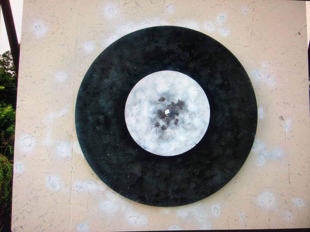

I put all my eggs in one basket and went with a .198" FB with the intention of shooting 140 Hybrids at an upper node and the planets aligned. If 130's shot this good I would have no problem shooting them either. With your barrel length and depending on FB you might be running the 140's a little faster. Mine shot great at 2780, sub 1/2 moa all the way out. Then I put the coal to it and it like some pressure approaching max. I couldn't be happier with it, current lot of H-4350 I had to back off to 2880 FPS.
BAT VR Pic
Bartlien 28"

8.5 twist 4 groove 26” Krieger. Berger 130 gr Hunting VLD jammed 0.015”, 39.0 gr Varget , CCI 450 is magic at 3010 FPS. Shoots sub 1/4 MOA at 600 and 800 yards in the dark with night vision btw. Tried 140 gr Hybrid but didn’t seem to have as much potential but in all fairness didn’t give it near the chance due to twist calculator saying it was marginal.
