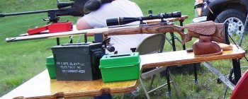

The 6.5x06AI is one of my favorite rounds. I shot out 4 barrels in IBS 1k matches 2 more on Varmints, and still shoot it for long range Varmints. 1200 is the max rounds you will get out of a barrel. I have shot Hart and Kreiger barrels 1:8 30 in. 140 Amax, 140 Berger, 142 SMK are my favorite bullets. Got as high as 3400 with a 142 and RL-22. Tried both 4350's, Rl-22 but H4831 SC was the best and most accurate around 3050. Hitting some varmints at 1600+ yds. currently shooting molly 142 bullets and H450 ball powder around 3100. It is a great round and really reaches out there. I think Molly and Ball powder makes a barrel last longer. I will let you if it makes a difference. I am currently on 3500 rounds out of a 243 with molly and ball powder. ;D
