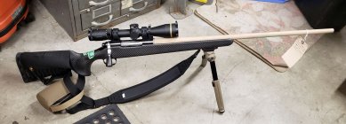

I have built (3) 6.5-06 rifles with the A square reamer.
In September 2015 I called up Forster and went around and around until they sent me a 25-06 Full length sizer die body honed out to a 0.292" neck.
That would make it an ideal 6.5-06 sizer die body, for $57. [double the honing charge]
I called up Lee and went around and around until they agreed to reduce a 270 mandrel from a collet neck die down to 0.262", but leave the top 1/4" alone to fit a 270 collar.
This will make it ideal for turning a 270 Lee collet neck die into a 6.5-06 die.
$20 plus shipping [quadruple the standard mandrel reduction charge]
At both Forster and Lee they had to go talk to the machinist to ask if it is possible.
120 gr Nos Bal tip moly with 50.7 gr IMR4166 powder 3.34" that QL estimates at 3236 fps 65 kpsi
chronograph 3197 fps
0.87" 5 shot 100 yards.
