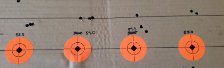

Just got home. Pretty good conditions to shoot in. Slight breeze from 8 oclock position. Pushed my poi about 1/2" right from yesterday but they were still lining up over my target so I did not click left. I shot 58.5 to 60 grains today at 200 yards again. Average velocity at 58.5 was 3100 fps. 59.0 was 3139 fps and 59.5 was 3136. I only had 2 shells loaded at 60 and they were at 3144. I still have no pressure signs. I am on my last box of 140 VLDs so don't want to shoot them all up on load development and not have any for practice and hunting this fall. Berger please run more 6.5 140 Hunting VLDs!!!! I am inclined to start a seating depth test at this time but I am not sure what charge weight to use. My gut tells me to focus between 58.5 and 59.0 but my velocities are more stable between 59 and 60. FWIW, all these test loads were loaded at -.010" off of zero jam. If I go longer I won't have much bullet in the neck. I really hope jump shoots better.

It finally warmed up enough to run mine through its paces. 143gr ELD-X and N165 starting 0.020" off the lands, 24" barrel. I fired a series from 55.0gr to 60.0gr in 0.5gr increments at 100yds just to find pressure before doing a 300yd ladder test. All 11 shots landed in a group 0.5" vertical by 1.5" horizonal; all but three of them went into a ragged cloverleaf. Velocity started about 2900fps and 60gr was 3138fps.
No pressure signs until 59.5gr, when there was a slight ejector mark. At 60gr it was more pronounced, the primer was flatter, and the bolt was a bit sticky. In my experience a fairly steep pressure curve but I'm happy there is the potential for an accurate load over 3100fps (hit that at 59.0gr). Nothing over 60gr would be usable due to brass abuse so I didn't test higher.
I'm going to shoot a 300yd ladder from 58.0 to 60.0gr in 0.2gr increments to look for a node.

I finally got back out for load development; it was 90F instead of 55F so the same loads were running hotter. I didn't make it through my ladder at these temps and quit at 58.8gr due to pressure signs. However I did seem to have a node at the low end, so I shot groups at 100yds at 57.5gr, 57.7gr, and 58.0gr. 57.5gr yielded a half MOA group at 3108fps avg and no pressure signs, which were starting at the higher charges. So I'm going with 57.5gr as it's accurate and safe at all temps. 143gr ELD-X. 24in barrel.
